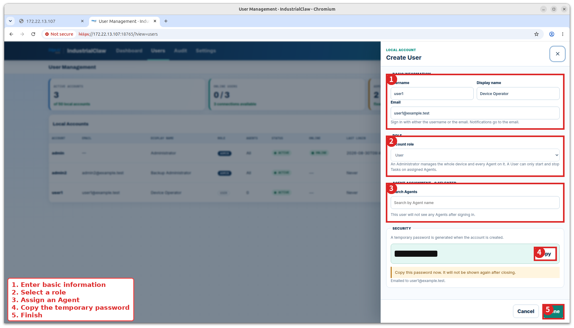

Create an account​
Open Users → User Management → Local Accounts → Create User and fill in:
FieldNotes
AccountThe sign-in name. It cannot be changed later.
Display nameThe name shown in the Dashboard.
EmailRequired and unique. It can also be used to sign in.
RoleAdministrator or User. It cannot be changed later.
Agent assignmentShown for the User role only. It decides which Agents that person can see and operate.
Select Create User, then copy the temporary password immediately—it appears once and expires after 24 hours.
View: Temporary password
Temporary password
If the invitation email fails to send, the account still exists. Pass the temporary password on through a secure channel instead.

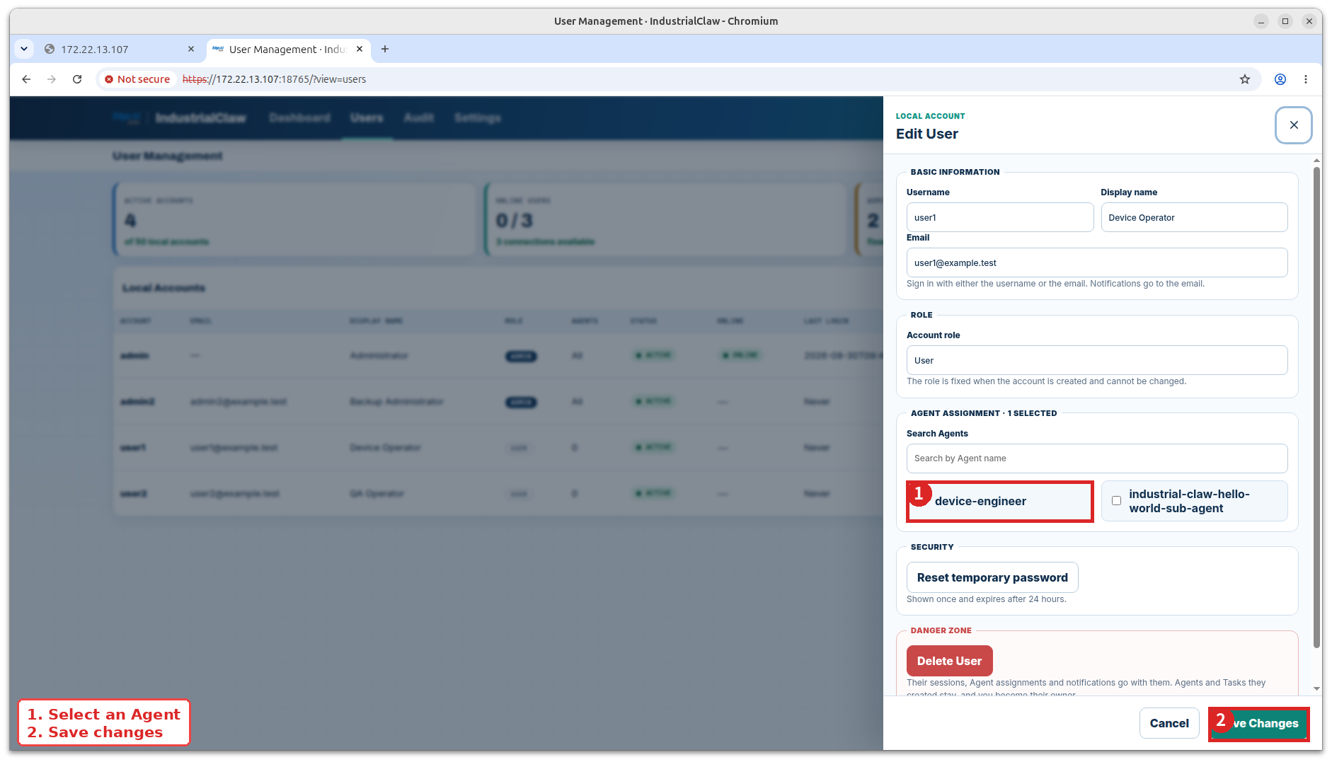

Change permissions​
Open Users, select Edit on the account, tick or untick Agents under Agent assignment, and select Save Changes.
View: Agent assignment
Agent assignment
Changing an assignment ends that person's current session immediately. They sign in again and the new scope applies. Only an Administrator can change assignments.

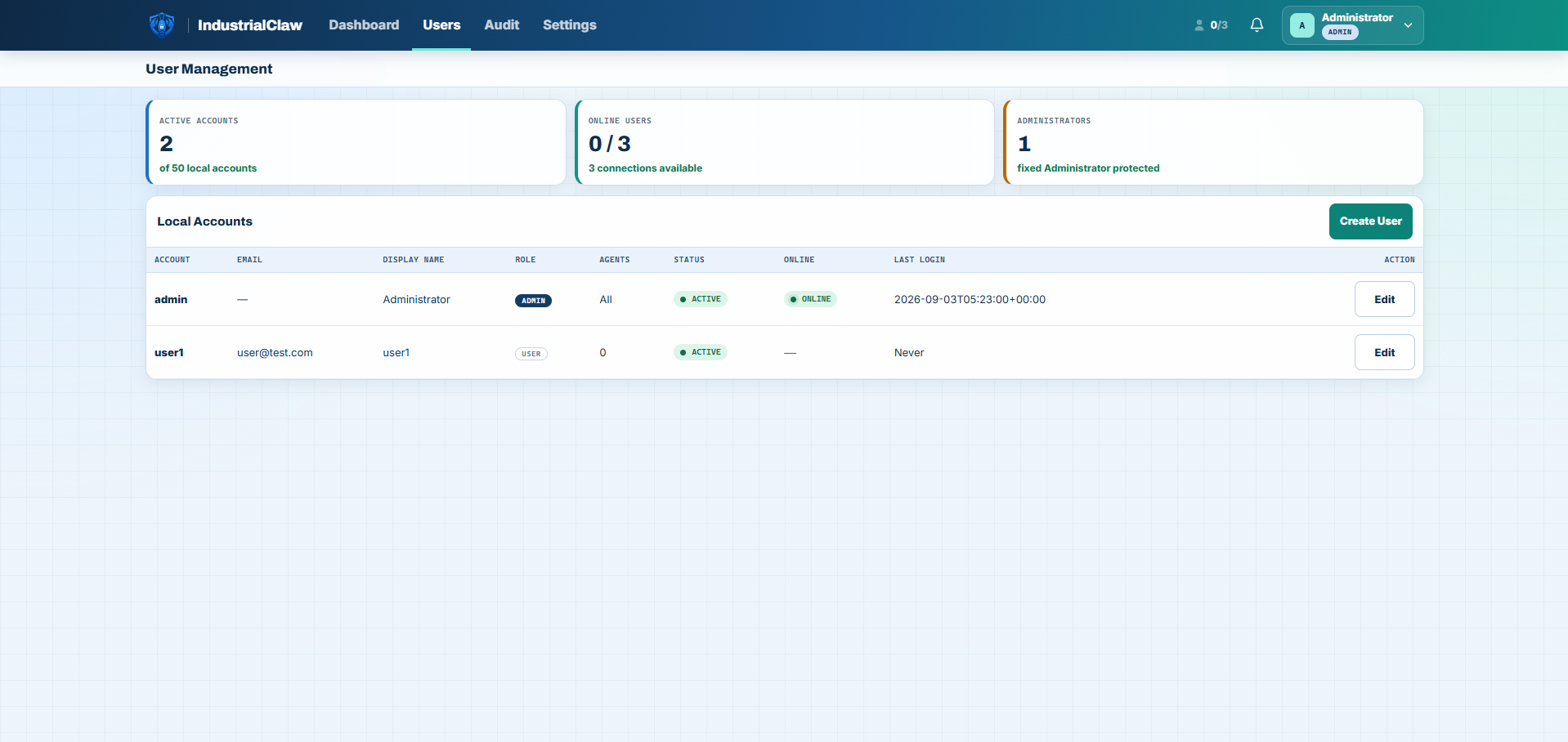

The Users page​
ReadingMeaning
Active AccountsHow many accounts exist, against a limit of 50.
Online UsersHow many are signed in right now, against a limit of 3. The bootstrap admin does not use one of those slots.
AdministratorsHow many Administrator accounts exist, against a limit of 10 besides the bootstrap admin.
Local AccountsAccount, email, display name, role, how many Agents are assigned, status, online state, and last sign-in.
