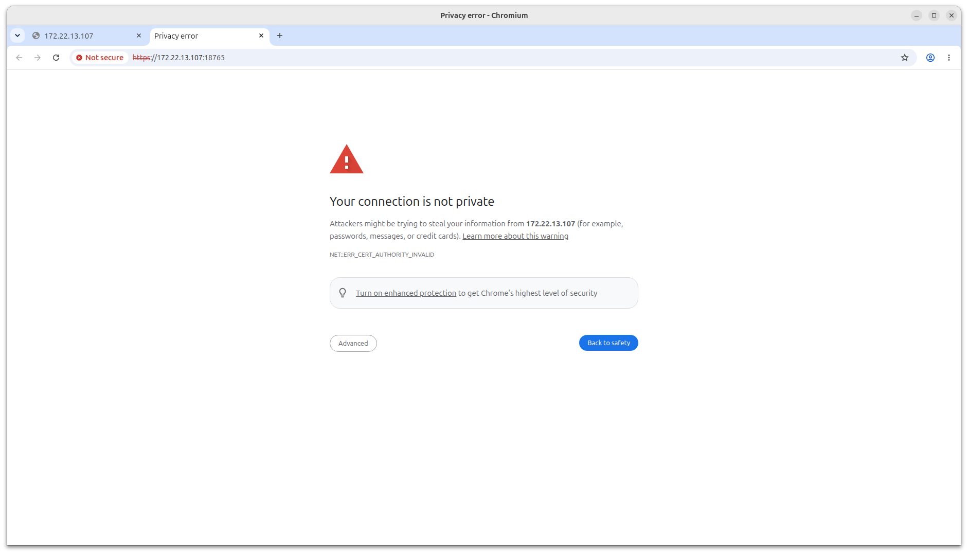

The browser shows a warning on the first connection. Open the advanced options and continue.
View the certificate warning
Browser certificate warning

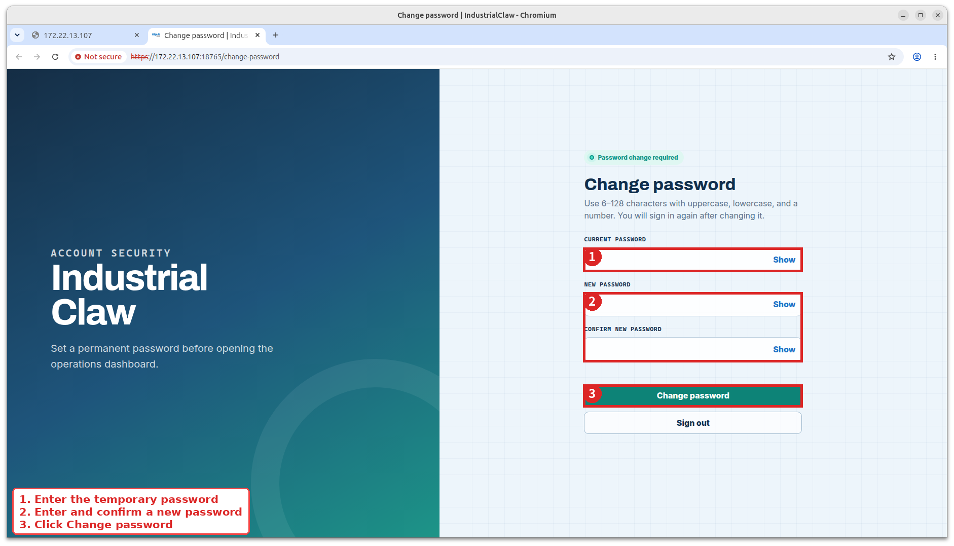

The Dashboard immediately requires a password change. The new password must be 6–128 characters and contain uppercase letters, lowercase letters, and numbers. Sign in again with the new password.
View: First sign-in password change

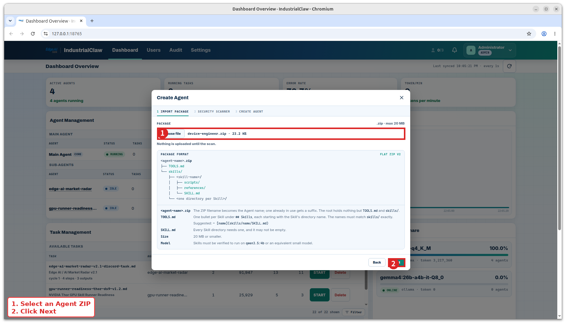

3. Import the Agent​
  1. Open Dashboard → Agent Management and select Create Agent.
  2. Under Import Package, choose device-monitor-agent.zip and select Next.
  3. Under Security Scanner, review the device-monitor Skill's risk, file locations, permissions, mounts, and ports.
  4. Acknowledge any finding that requires it, then complete Create Agent.
View: Import Package step
Import Package step
View the security scan
Security Scanner results
View the created Agent
Agent created
device-monitor-agent now appears in the list with no Tasks yet—that is expected. Tasks are created separately, in the next step.

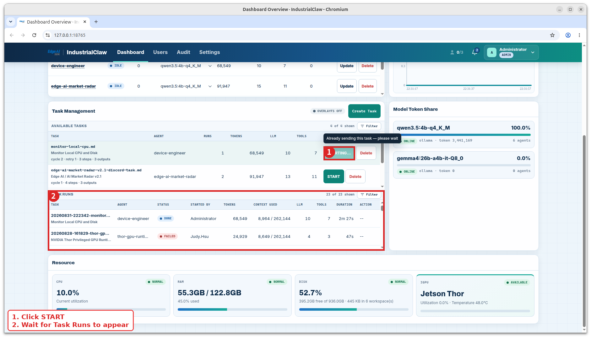

5. Start the Task​
Select START on the monitor-local-cpu-task row. The button briefly shows STARTING…, and a new record appears under Task Runs.
View: Starting a Task
Starting a Task
START creates, claims, and dispatches the run in one call, so it never waits in a queue: the record appears as running and ends as done or failed.

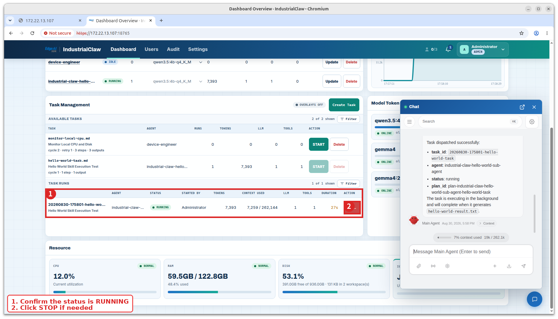

View a running Task
Task running

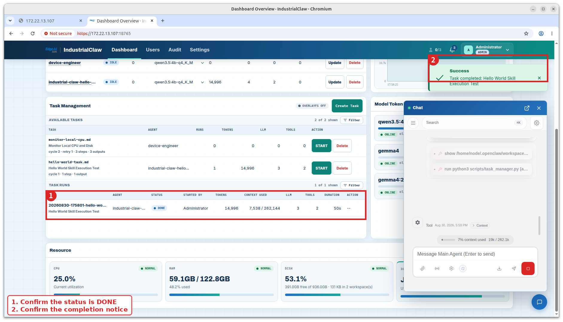

View a completed Task
Task done
You do not start an Agent container by hand. START creates, claims, and dispatches the run, and writes an Audit record naming who started it.

The run reaches done only when Final Verification passes and all three reports exist as regular files. The platform verifies those files; it never creates, copies, or moves them.
